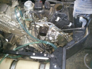

Here's one! The pump is on the seat rail.

PostSubject: Re: relocating fuel pump 660   Tue May 21, 2013 5:35 pm
Is that the Rutting Rhino setup !

onebuilder wrote:
I thought the pump is suppose to be mounted above the carb???
On the RR setup, I think it is below the tank so that it pulls from tank better and doesn't loose prime as bad.

PostSubject: Re: relocating fuel pump 660   Tue May 21, 2013 6:20 pm
Firefighter wrote:
Ok, where is the return line hooked in?

PostSubject: Re: relocating fuel pump 660   Tue May 21, 2013 6:31 pm
It is the RR setup and the return goes line goes from the pump to the left in the picture under the seat frame.

PostSubject: Re: relocating fuel pump 660   Tue May 21, 2013 8:25 pm
Doesn't the return line feed back to the tank through his billet pick up??

PostSubject: Re: relocating fuel pump 660   Tue May 21, 2013 9:19 pm
Correct, All return lines dump back into the tank at the pickup. I think he was using the Axia billet pickup.
I am curious as to how he was getting the fuel to send to the return. Weller uses a tee on the supply to the carb. Is RR using one of pump outlets? Installing a restrict or in the line?
