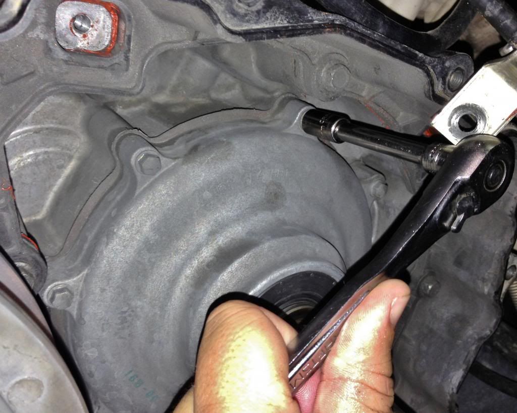

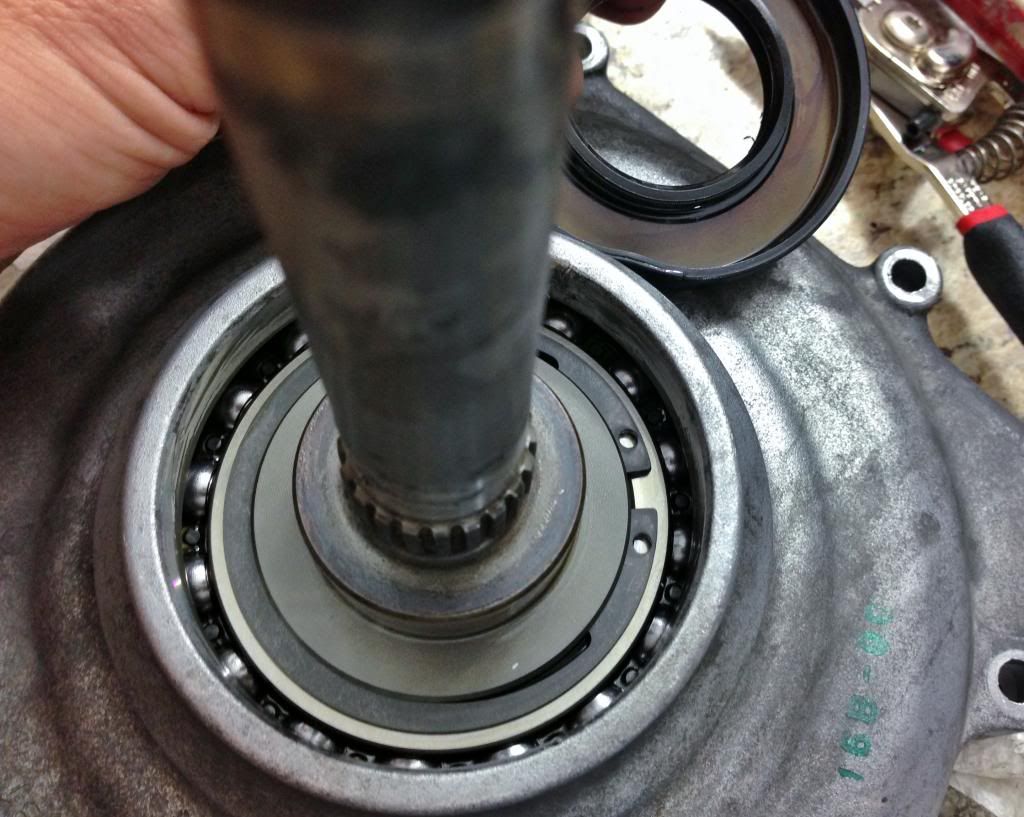

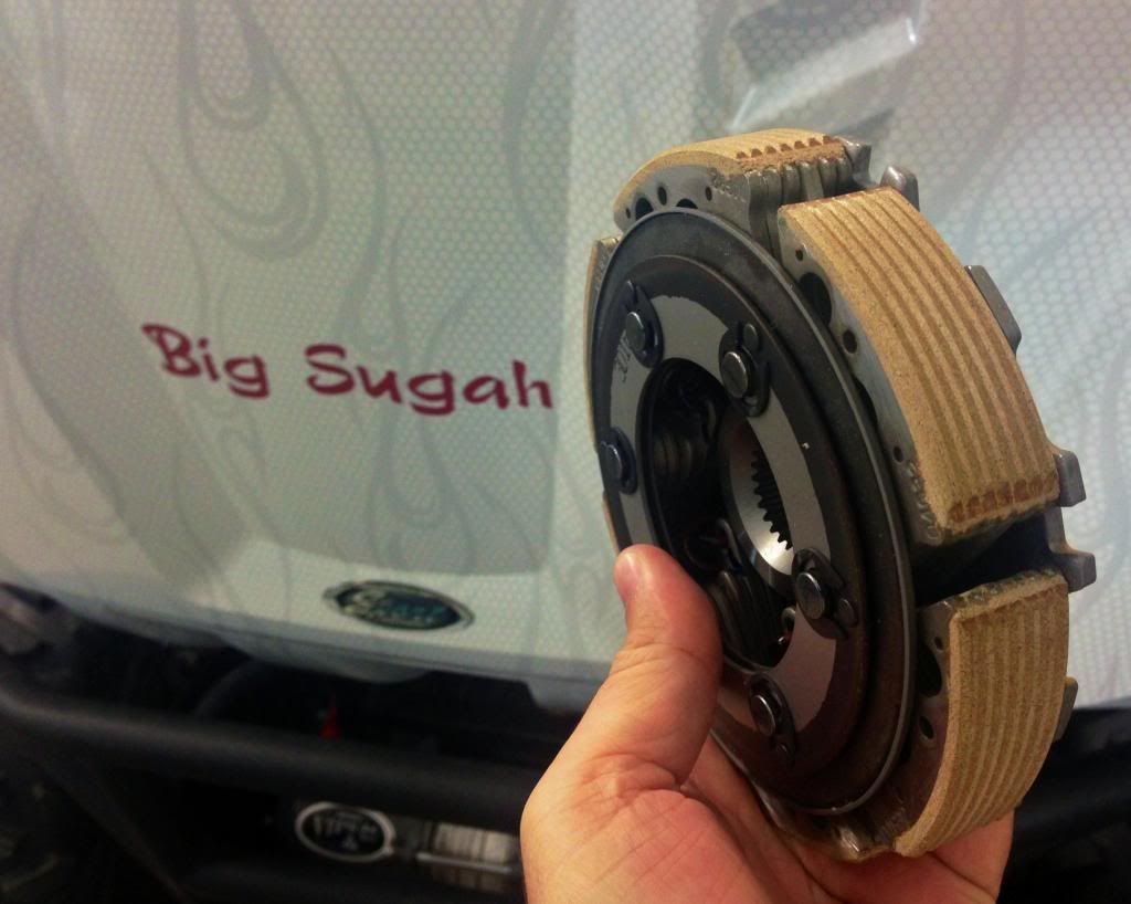

PostSubject: Re: Rhino 700 Wet Clutch   Thu Sep 19, 2013 12:15 am
I am in the middle of a write up. I am kinda dragging my feet on purpose to see what happens with the upcoming forum move. I don't want to write it all up and then we have to start all over. lol
I'm lazy like that
Anyway, here's a couple of pics to tide you over.
Step by step of the slug process coming up... of course using the lazy method: KMS slugs. You could use lead if you have a good scale and are able to sneak a spoon past the spouse.
Behind this door, the prize awaits
Old vs New
James had me all skeert. They say a badly worn wet clutch can begin breaking apart and dumping the friction material in the engine oil. Do you know how much trouble I'd be in with the Mrs. if I destroy my build 734cc motor? I don't even want to think about that.
The drum doesn't just fall off the cover. Neither does the needle bearing. Or the oil seal. Or the roller bearing. My patience was wearing thin.
Wet Clutch Good Times!

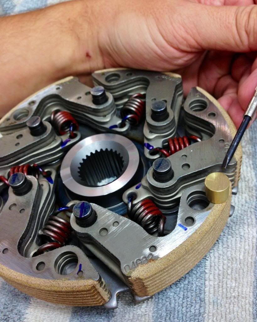

PostSubject: Re: Rhino 700 Wet Clutch   Thu Sep 19, 2013 7:28 am
Ok, I'm dumb.  I see this all the time...what the heck do you mean by "slugging" the wet clutch???
_________________
2013 Rhino 700...with Trail Bright 12" Double Row LED's from Flimmy, 26" Maxxis Bighorns, ITP SS108's, Warn Vantage 3000 winch
View user profile
ChrisH
avatar
Posts : 475
Age : 35
Location : Texas (Victoria Area)
PostSubject: Re: Rhino 700 Wet Clutch   Thu Sep 19, 2013 9:19 am
Slugging the wet clutch, in just a few words, involves adding a few grams of weight to the wet clutch shoes. The added weight increases the clutches' clamping force against the drum. The clutch slips less, and this means better power to the wheels and longer clutch life. This mod is especially helpful on rigs with larger tires and/or higher HP motors.

PostSubject: Re: Rhino 700 Wet Clutch   Thu Sep 19, 2013 9:39 am
Yes, who can forget mud the consistency of peanut butter? Slugging the wet clutch helps there as well, lol!
